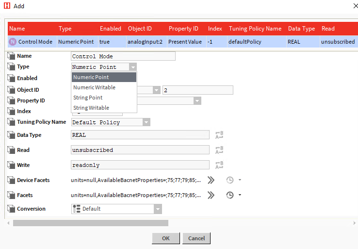

I’m trying to bring an Analog Input point via BACnet. Its an enumerated value but only shows up as a numeric in Niagara. The Type option does not offer an Enum conversion. I also tried the Conversion option and selected “Enum Value Conversion” option, it appears to do nothing.

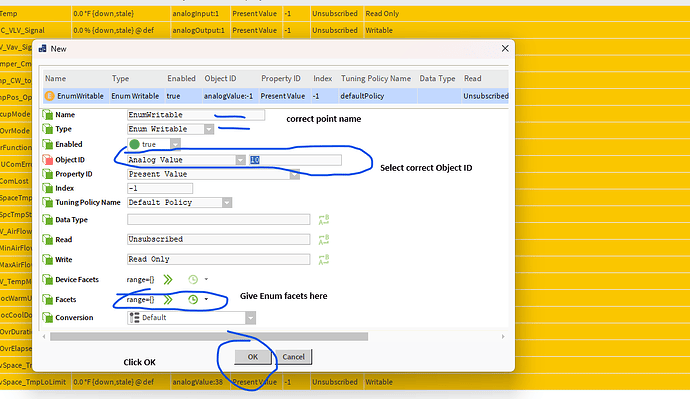

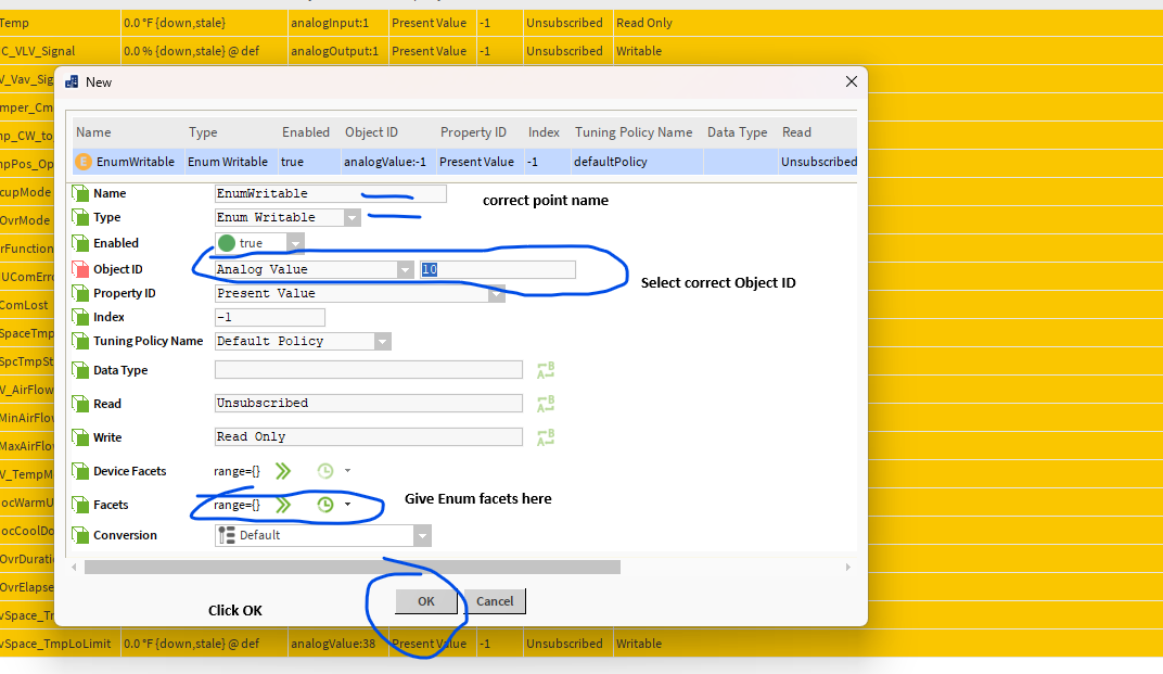

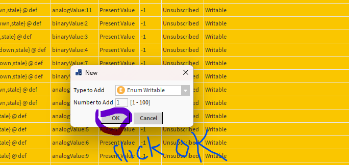

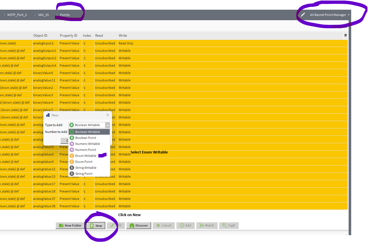

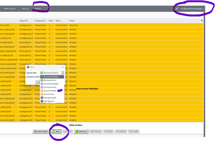

@Boba Please follow steps mentioned in screenshots shown below:
