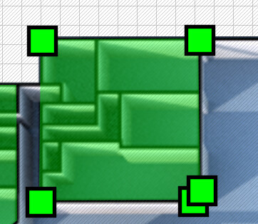

Hi All, does anyone know if it is possible to adjust the handle size when editing shapes like polygons? It is an absolute pain in the as when you’re trying to align precisely to something below it. Even a adjusting the opacity of the handle would help.

I think he means the boxes at the corners to resize components?
Correct, I mean the handles, the green boxes :sweat_smile:
A trick for this is to use the arrow keys. Hold left ctrl while pressing the arrows for smaller movements. With polys I like to turn off snapping, this way your free from the gridlines to move the handles wherever you like.

There are zoom in, zoom out and a third key that sets zoom level to normal. if you goto px file editing mode, spam the zoom out button, then click on the third magnifying glass to goto normal zoom level, you’ll see that the “handles” are smaller.
lmk if you need more details or screenshots.

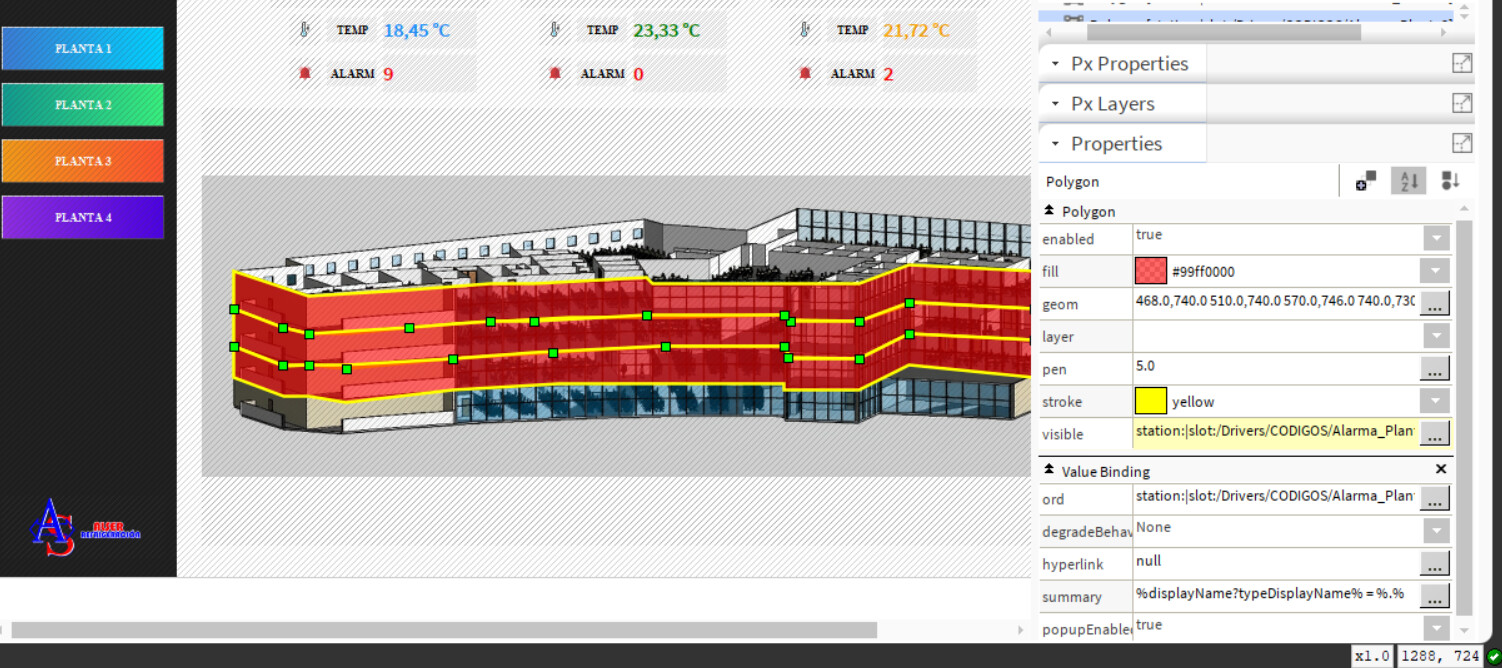

you can use geom, you use coordinates (you can find the coordinates at the bottom right).
In this example I am using three polygons and to make them all fit I just left the same coordinates.
floor 3 : 468.0,680.0 510.0,690.0 570.0,690.0 744.0,674.0 928.0,664.0 1090.0,664.0 1270.0,660.0 1276.0,668.0 1390.0,670.0 1480.0,640.0 1670.0,650.0 1820.0,590. 0 1820.0,520.0 1670.0,590.0 1470.0,580.0 1390.0,610.0 1270.0,610.0 1060.0,610.0 1050.0,600.0 870.0,610.0 800.0,610.0 670.0,620.0 510.0,630.0 390.0,590.0 390.0,650.0
floor 2: 468.0,740.0 510.0,740.0 570.0,746.0 740.0,730.0 900.0,720.0 1080.0,710.0 1270.0,710.0 1276.0,728.0 1390.0,730.0 1470.0,690.0 1670.0,700.0 1820.0,640.0 1820. 0,580.0 1670.0,650.0 1470.0,640.0 1390.0,670.0 1280.0,670.0 1270.0,660.0 1050.0,660.0 870.0,670.0 800.0,670.0 670.0,680.0 510.0,690.0 468.0,680.0 390.0,650.0 390.0,710.0
floor 1: 470.0,790.0 510.0,790.0 570.0,800.0 740.0,780.0 910.0,770.0 1090.0,770.0 1270.0,770.0 1270.0,770.0 1270.0,780.0 1390.0,780.0 1470.0,740.0 1670.0,760.0 1820.0,690.0 1820. 0,640.0 1670.0,700.0 1470.0,690.0 1390.0,730.0 1280.0,730.0 1272.0,710.0 1070.0,710.0 870.0,720.0 740.0,730.0 570.0,740.0 510.0,740.0 470.0,742.0 390.0,710.0 390.0,760.0
