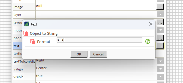

New here and my first post. A question I am trying display only seconds on a px page without any decimal places. I reviewed the BFormat Cheat Sheet and tried a few different things but it did not work (%out.Minute%)

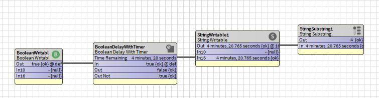

The program object is Boolean Delay With Time, Time Reamaing Output to a String Writable which converts the display from seconds to ms.
First of all, welcome @mreining . To answer your question:

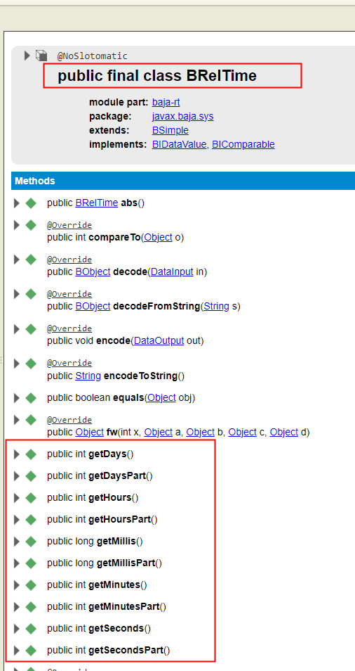

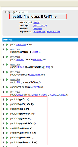

In you’re case you are BFormatting the object type of BRelTime. When we look at the bajadoc for BRelTime we can see all the methods available to us. As a general rule when using BFormat we can use any methods that begin with get, do not take any arguments and are not void.
In BFormat we simply drop the get and () and use camel case. For example:

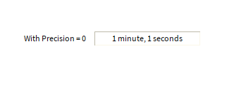

If we want to return just the seconds part, we can see in the bajadoc we have the method getSecondsPart() which in BFormat would equate to %secondsPart%.

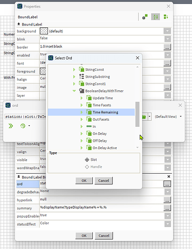

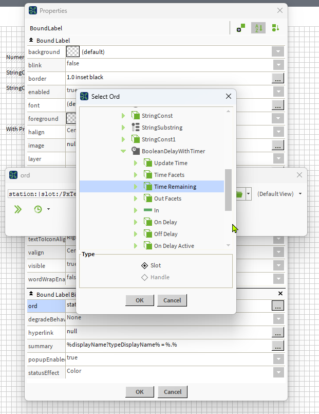

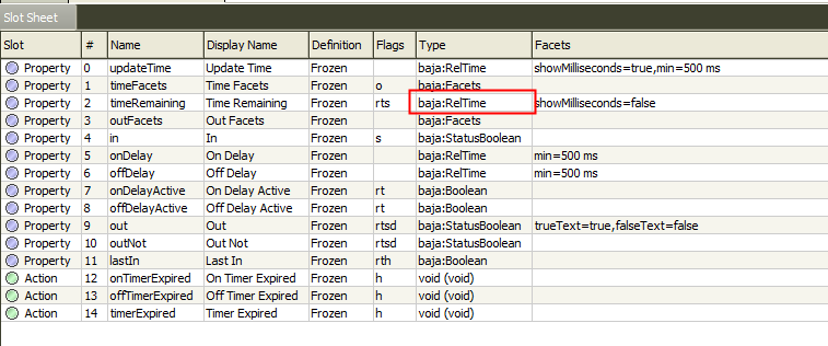

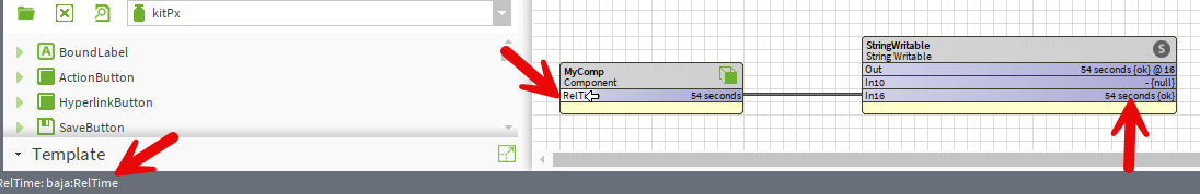

When we look at the slot sheet for the BBooleanDelayWithTimer we can see the slot type for timeRemaining (this is how me know what type to lookup in the baja doc and what methods we can use):

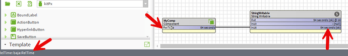

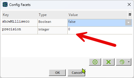

I noticed, though, that the intial question mentions the slot whose value he wants to display is from a ProgramObject and his image shows decimal places where a BRelTime doesn’t appear to show decimal places (by default) when linked to a String slot.

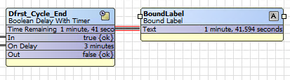

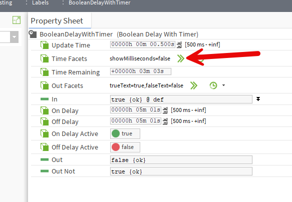

Thanks for the information. I was unable to use the BFormat as posted. The boolean delay with timer displays (axcommunity or vykon block not sure) is correctly but when linked to the px page in a bound label is shows the seconds to the thousands.
