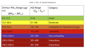

Looking to get an enum value from the Tridium weather service AirNow.gov values. Typical Tridium gives me the Ozone and Particulate 2.5 values but not the AQI value. Whats frustrating is there is an Air Quality view on the provider that shows the AQI. The actual AQI is based on the highest of the 2 properties. Table of values is fairly simple and would like use an array to find the AQI index.

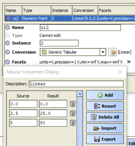

I realize that I could use a bunch of > < blocks or a selector, but having a table function that you could map non-linear values would be neat. Asked Tridium if we could use the Generic table function that was part of kitIO (Think it now lives in nrio module) and heard crickets.
