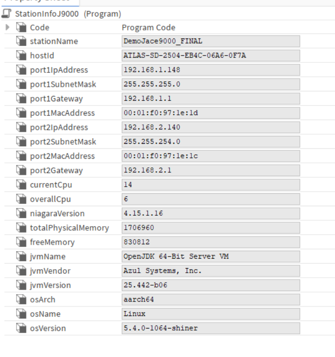

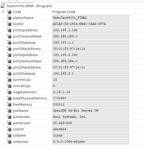

Here’s an example of my program object I have for a station info in a 9000. I also have one for the 8000 and our JENEsys edge controllers as well.
There is some good information from that SysInfo block, but I think the information about the homes needn’t be there. I’d also hide the actions.
You get the picture though.
