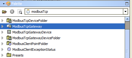

Does anyone know if it possible to use the onboard RS-485 connecter on an ECY-S1000 for a Modbus network and then bring those devices into a JACE using the Modbus TCP Gateway Network and pointing it to the ECY.
I have played around with this and can’t get it working so I’m assuming its a hard no. But if anyone has some incites please share :smiley:

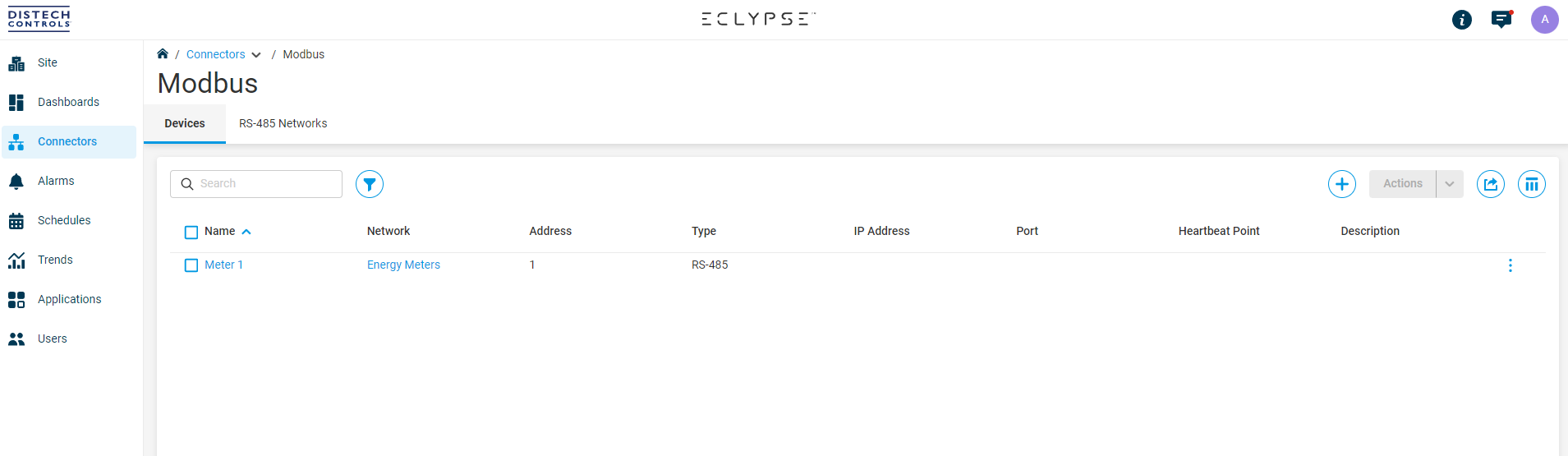

I have an energy meter connected to the RS-485 port on the ECY. There will be multiple.
Then I want to bring those into niagara as modbus TCP gateway devices. By pointing the ModbusTcpGateway network at the ECY IP. Then adding the gateway devices with the matching addresses.
Essentially I want to cut out the step of having to add the Modubus points in the GFX program and then route them to BACnet points to bring them into the jace.

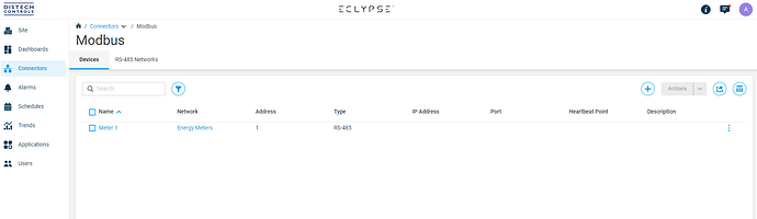

Thanks for asking @ControlFreak. I have a licensed ECY-S1000 for modbus connection. I am able to connect the meters to the RS484 and add them to the ECY. This was more of a me being lazy and not wanting to have to go the hard route of creating BACnet points in the ECY to write the modbus points to in order to discover them into the jace. It seems after trying lots of different things that it’s not possible. Guess i’ll have to stop being lazy :rofl:
