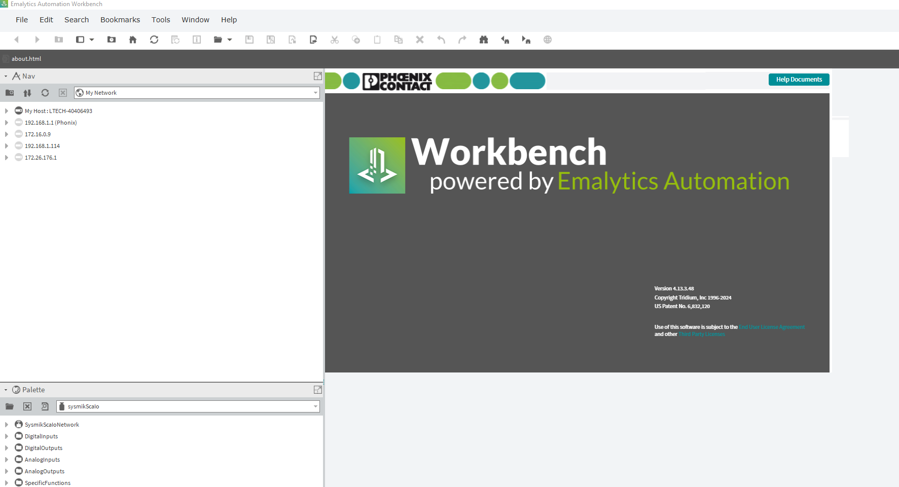

Emalytics is just line Niagara but it look a little different

The software is just like niagara 4 or Centraline, I just hoped that somebody had worked with the Phønix product, because nobody in Denmark use them for Building management, I hear that Germany use them.
There are few companies / people that use it here in the UK as well. From what I understand it is a NiagaraN4 powered hardware platform (similar to the ISMA MAC36’s).
If you’re familiar with using Jace’s with ISMA IO it shouldn’t be that hard to adjust to. Its all engineered in N4 workbench as you normally would and I believe the Phoenix Contact install comes with their required JAR modules.
