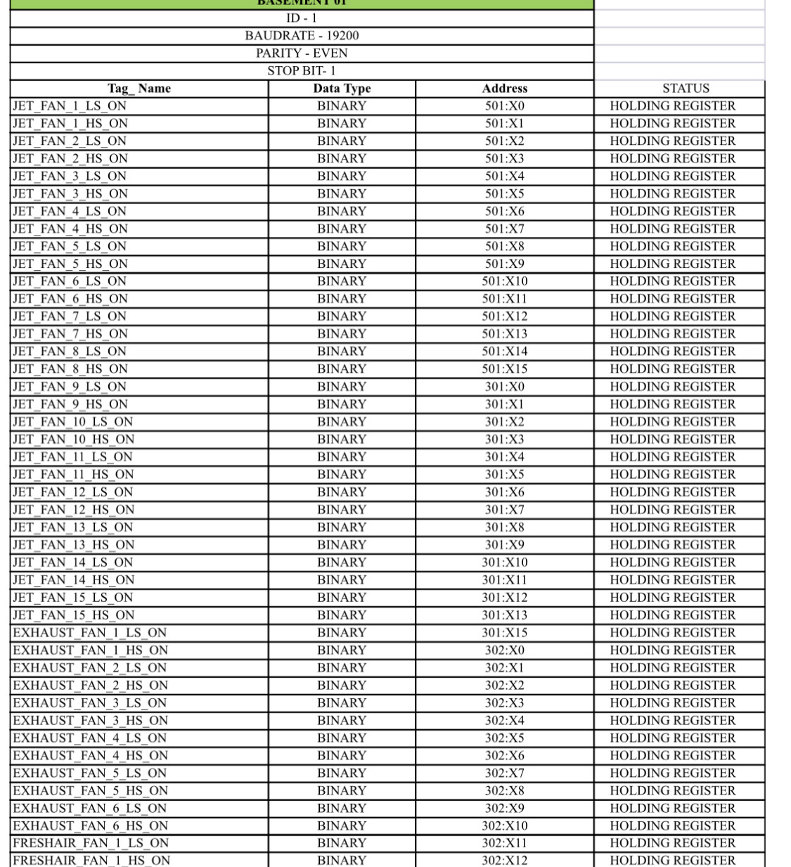

How to configure below Modbus points

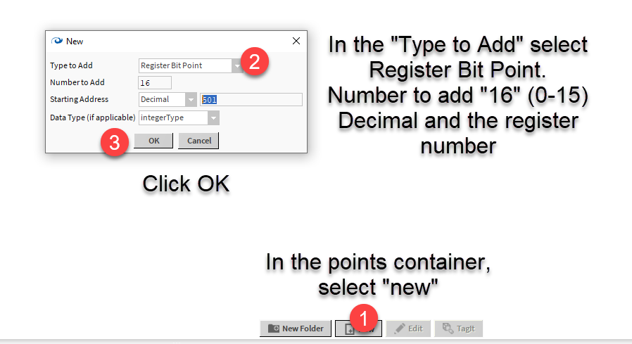

Assuming you already have the device in your ModbusAsyncNetwork, proceed to the points container of that device. Select new and then in the dialog container, change the type to register bit point how many of them you want to add, and the starting address. Once you have selected all that, click OK

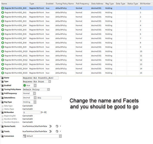

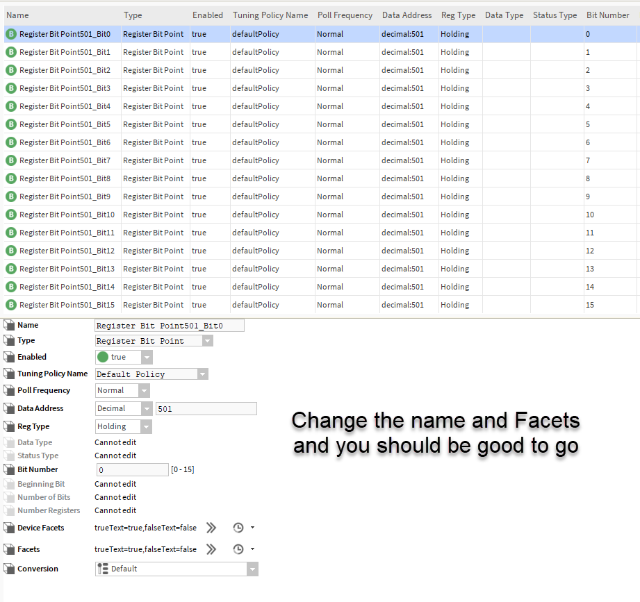

Then change the facets and the names of the bits that you are bringing into your project.
