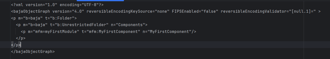

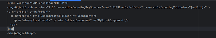

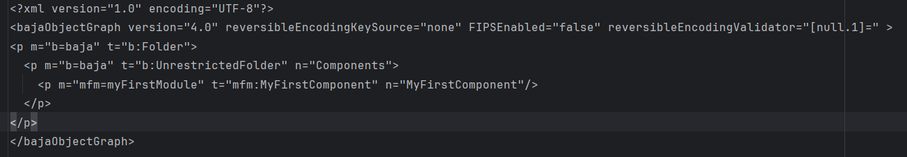

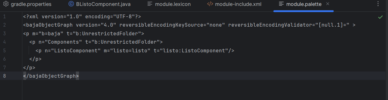

I solved the error with the help of claude ia, I only had to change the part of module.palette this was the change that was made:
Use the traducotr deepl, in case you find some incosistencia in the previous text.
Can we see the details of the screenshot?

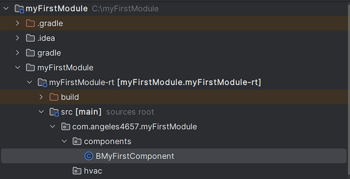

I went back to check the code, and I noticed that I had made a mistake in one letter, hahahaha, an apology. I had put myFirstComponent instead of MyFirstComponent, as I was only watching the video and after finishing the practice I got confused.

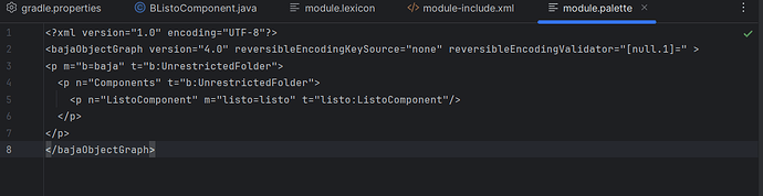

I have a doubt, what would be the difference of the structure proposed for the module.palette in the video 5 against the structure that calude.ia recommended me?

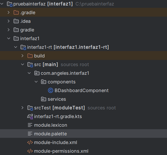

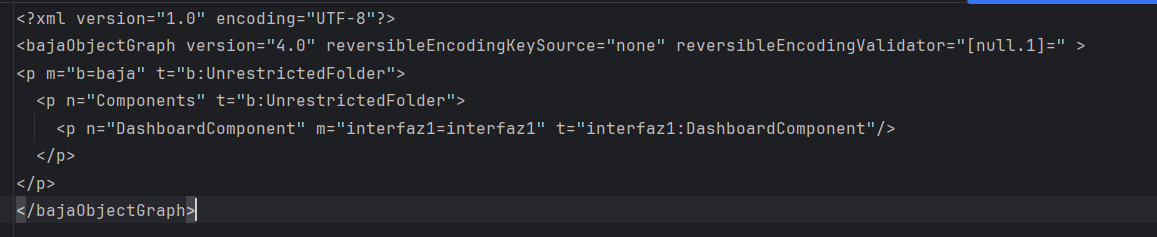

For example I am creating a new module and this is my structure for the module.palette
β€”β€”β€”β€”β€”β€”β€”β€”β€”β€”β€”β€”β€”β€”β€”β€”β€”β€”β€”β€”β€”β€”β€”β€”β€”β€”β€”β€”β€”β€”β€”β€”β€”β€”β€”β€”β€”β€”β€”-
The differences don’t really mean too much here. If all components are from the same module, you only need the reference once until you change the module. Some people keep the module m= throughout their whole palette, and that’s fine. There are a few ways in which it could work. If you built it in claude and you were able to get the palette correct, then it shows you that both ways would work.
