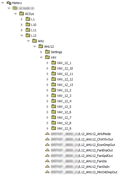

Example of what I mean by history grouping:

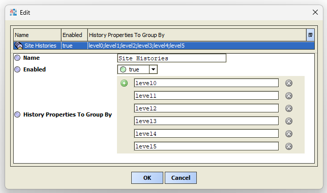

  1. Define History Group: Create a history group in your Niagara station with sufficient levels to cover the number of folder levels used for your points.

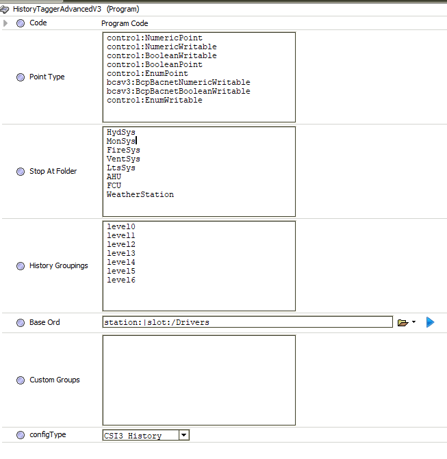

  2. Configure the program object like shown in the example below (your configuration might be different):
Configuration Parameters:
  • Point Type: Specify the point types for the BQL query, with each point type on a new line.
  • Stop At Folder: Indicate the folder levels where the program should stop tagging. Multiple folders can be specified, each on a new line.
  • History Groupings: Define the history groupings exactly as they were created in the history group setup, with each level on a new line.
  • Base Ord: Set the entry point for the BQL query.
  • Custom Groups: Name/value pairs for adding custom tags not defined by the history group. This is optional and typically not needed.
  • Config Type: Specify the history extension type to search for.

    For Example, if the stopAtFolder is {ACSys} the program will query all points of the selected pointTypes list
    that are a chilled to ACSys and then tag them from 0 to x folder levels. There is no limit to the depth
    however you must make sure you have enough depth to your history grouping under the history service.
    |ACSys (Level0)
      |-L2 (Level1)
        |--AHU (Level2)
           |--AHU1 (Level3)
              |--ZnTmp1 (Level4)
