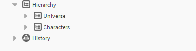

You should provide a .bog of your hierarchyService and a screenshot of your hierarchy

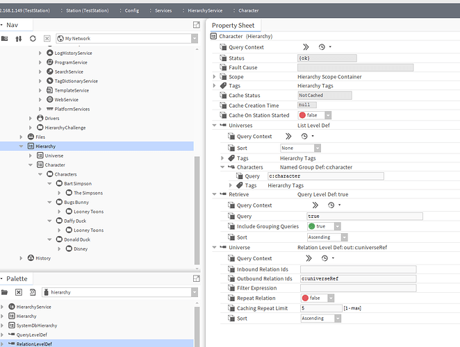

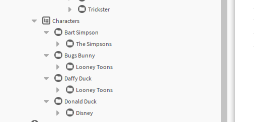

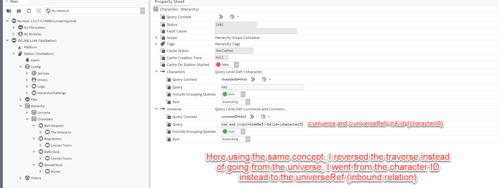

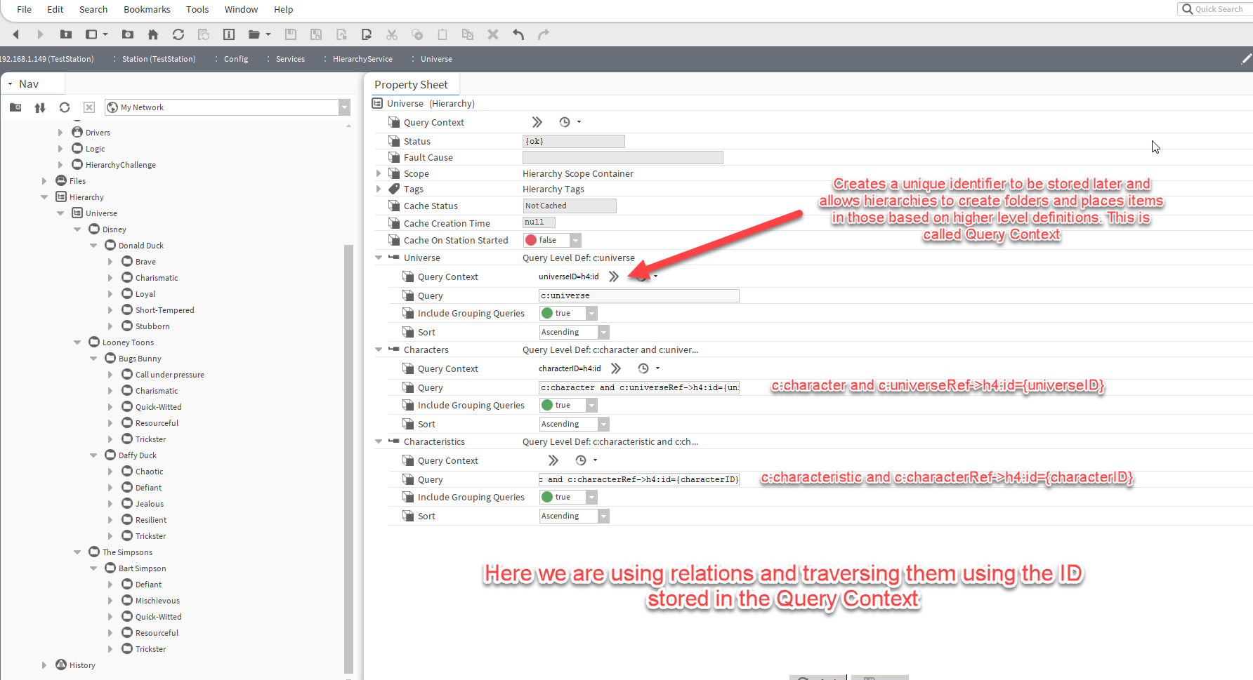

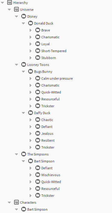

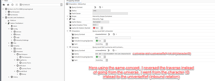

I believe this is fairly true to the instructions except for the fact that in the second hierarchy I threw in a query level definition of characteristics to make the hierarchy work, but, although it gives the structure of Characters > Universe…it includes the characteristics, so it has a bit more than instructions asked for. Is there a way to do a ‘blank’ query to get rid of this? (it looks good until you go down another layer). After learning more, it was kind of trivial to get it to work.
This is the overall structure:

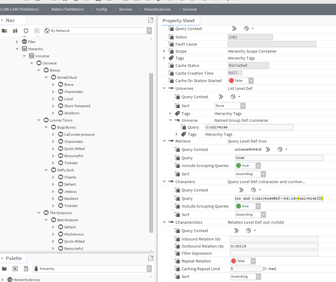

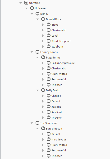

This is the first Hierarchy (Universe, universe, character, characteristic):
This is the second Hierarchy (Characters, character, universe):

All hierarchies need a queryLevelDef, regardless of function. You can just type the word “true” in the query (no quotes). This will return every component in the system but the hierarchy will only put together what’s officially tagged.
I remember you saying that in one of the videos. I knew I had to put something in queryLevelDef to get it to work, but I forgot about the “true” to be transparent instead of sticking an actual tag in. Thank you. And it helped me greatly to drag the queries, etc. instead of what I was doing trying to type in the “Slot” values (i’m sure this isn’t the right terminology?), that you showed on your videos! It really does simplify and avoid all the errors I was making. Thanks for your response, I’ll go back and change this and submit a corrected version later.
If you got the hierarchy to work in the pictures shown, I don’t think there’d be a need to resubmit. There are many ways to make these work.
If @Rosenthaler permits, I can make a video in the next week or so to show the multiple ways to do this.
You really only need niagara tags for this entire thing. No need for any other tag dictionary if you’re creative enough!

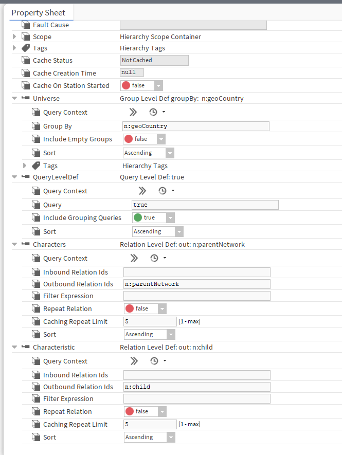

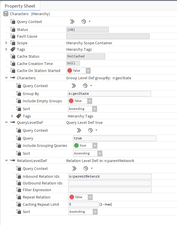

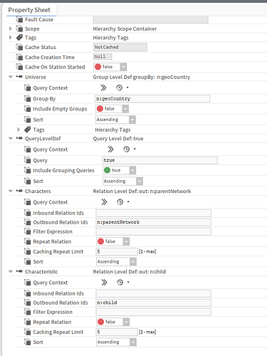

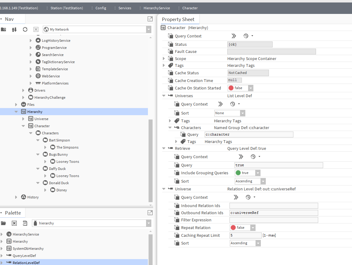

I won’t submit the bog but here is an easy solution only using Niagara Tags:
That’s a very elegant solution @Charles_Johnson :heart: love it!
@ControlFreak I’ll look into the bog soon, but judging from the screenshots it looks like you’re on to something right, but listen to Charles… He’s way ahead of me in hierarchies and his videos on the subject are amazing. If you wanna do a follow up video on the subject, I would love to watch it Charles.

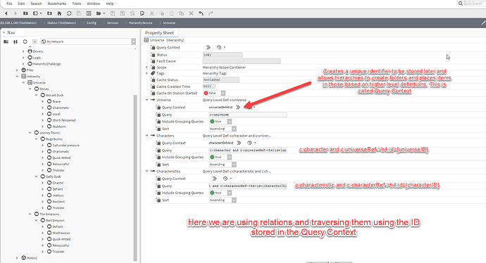

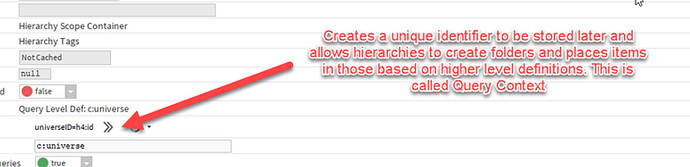

Here’s another example of creating then with using Query Context to generate the folder hierarchy for you:
You can even use listLevel/namedGroupDef as well.
Again, there are multiple possibilities.
My point is as long as you can build a hierarchy you’re comfortable with, becoming with optimized ones will come with time. Just like coding. Learn to crawl, then walk, then run.
